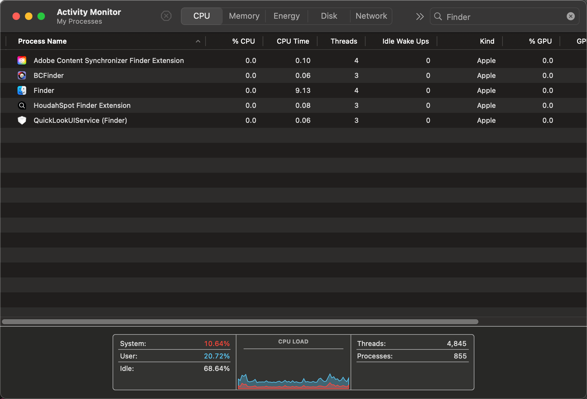

I do have other Finder extensions running, as you can see in my Activity Monitor:
Let me know how else I can help. Thank you so much for working with us on this!
