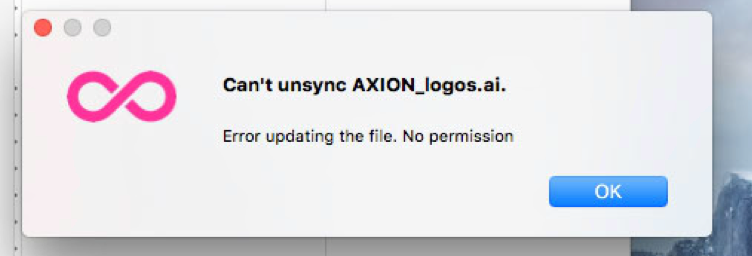

So I’ve searched all over the form and web and can’t find an answer to my question. I am running Odrive on an Apple Server and have been able to Unsync a couple files. Now I am not able to Unsync anything and when I try I get a message that says “Error Updating the file. No permission.” I definitely have permissions on this computer and I’ve tried restarting as well. We’re running OS X 10.11.4.

Unfortunately that does not work. See my screenshot.
After I do that the check goes away too.

Finally finished syncing everything. Still can’t Unsync. I open the folder all the way down to the last file.

You get this when trying to unsync that file directly (right-click->unsync on AXION_logos.ai)? If so, can you do it again and then send a diagnostic?
Yup. Just sent the diagnostic.

Hi @steven.johnson
I took a look yesterday, but it was inconclusive. The error is an OS-level error being reported to us that is basically saying we can’t properly delete the file (to unsync and replace with a placeholder).
If you are still seeing this error on this particular file, we can run a few more diagnostics on your system to see if we can figure out what is happening:
