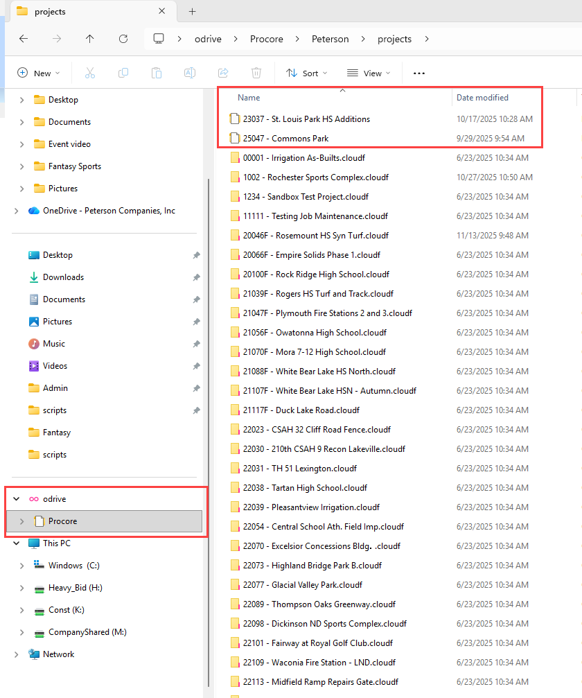

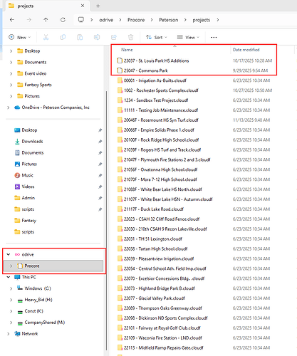

Have had a few users report synced folders and files not displaying correctly. Everything appears to be functioning and syncing just fine, but a visual eyesore. I did recently deploy v7426 out to all our endpoints. Any ideas?

It looks like the normal folder icon has a blank file icon on top of it, is that correct?
This is only happening within the odrive folder?
Does the effect stay when you switch the view (to content, tiles, details, large icons, etc…)?

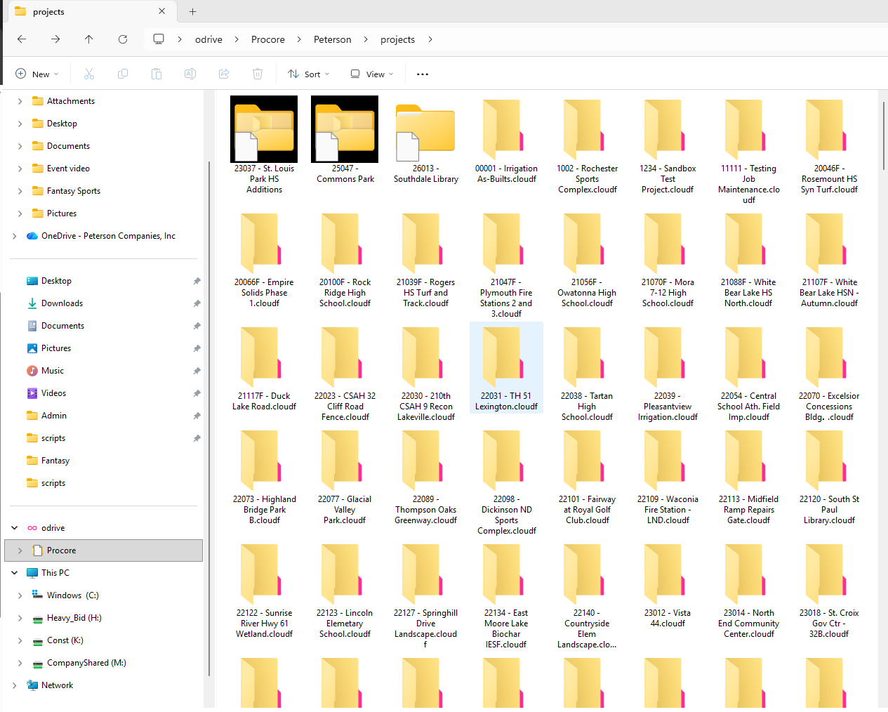

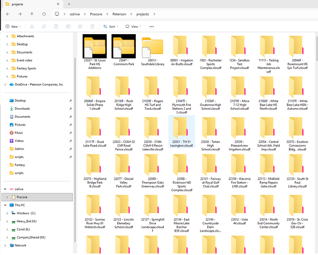

Hey @Tony ,
Correct, a blank file icon is displayed over any “synced” items. That behavior is present regardless of the view. In the image below, I changed the view to Large Icons, and synced a new job (26013) to see if the mirrored previously synced items -
This is while on Odrive version 7434 and Windows 11 24H2.
