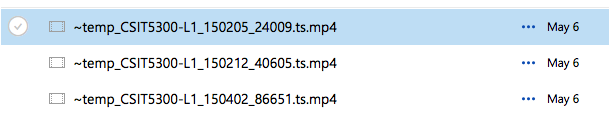

Then I logged to OneDrive for Business via the web and I noticed quite a few ~temp_ files. Indeed, all the files that did not sync had a ~temp_… file placeholder. I deleted them online and files synced successfuly. I did not see those files on my hard drive or on odrive web. Maybe you can make it more robust.

I was able to reproduce the problem. Quit odrive while it is uploading files to OneDrive for Business. After restart, files will stay in “Waiting” list until you delete ~temp_ files on the web.
I found another case where this happens. I have bunch of files in one directory. I moved them to OneDrive using mv command in Terminal. odrive started to sync them immediatelly and many of the files were copied only partially. I had to go online and delete ~temp files to get sync completed.

Thanks for bring your findings to us. Unfortunately, this is a known problem with OneDrive for Business source.
These are remote server’s failures which should be technically handled by server itself not by client (e.g. odrive app). Microsoft need to clean up these temp files but they don’t as of now =(
These are known cases which may lead to this problem:
- Internet / network faults during file upload
- Server/ request errors during file upload
- Exit and re-launch odrive app during file upload
- Select the file, Right click --> Stop during file upload
- Goto tray menu --> Syncing list, click on file name and press OK to stop the in-progress file upload.
- more… (means anything which may interrupt file upload)

I’m having the same problem, but can’t figure out a way of batch deleting these hundreds of ~temp files from the search across directories without installing the crippled Onedrive Business desktop client. The onedrive business interface doesn’t seem to allow it. Am I missing some straightforward way of getting rid of these ~temp things?
Unfortunately, there is currently no other option available to delete these temp files from OneDrive for Business. We fully understand that it is very painful for end-users to look for temp files and individually remove these files from the source but there is nothing much we can do =(
